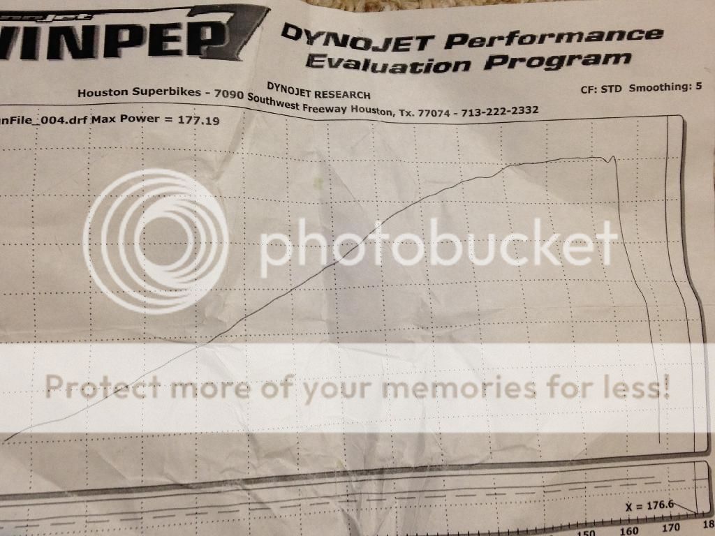

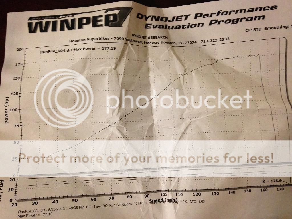

Trying to figure out which ecu flash to use ,I have the 2013 hp4 and last time I dyno it I got 177hp to the rear wheel and my top speed on GPS was 177mph on 190/50/17 tire stock gearing ,brenn flash says you gain 20hp and restriction are remove for top speed who has done the brenn flash and what did you gain I want to wait for the alpha flash and see the difrence so if you have done a brenn flash let me know what you gain on hp and top speed

Jimmy you running stock gearing? I would think you should have ran faster the 177 mph... You must have been running into a good head wind.. I would think these things should run 185 mph fairly easy in decent conditions... They are geared to go 190-192 ish with 17/45.
I made a quick hit on mine a couple weeks ago and saw 178 mph (speedo so its high) at 13,800 and that's with -1 up front. I figure it will run 180 mph (GPS) at 14,200 with -1. Wind has a lot to do with it.
I am also curious about the Flashes/tuners. I can see the power gain potential down low and midrange due to the throttle position restriction in the ECU until 9000, as far as top end power, I don't see how the flashes/tuners are really gonna add power over a dialed in Power Commander... UNLESS they add timing advance in the upper range. (Which I doubt)
Hell I know that if I could buy a tuner and gain even an honest 10 hp over my dyno tuned power commander setup, I'd buy one today... I just don't think there is much peak hp to be gained with one, especially on a bike that is properly mapped already.

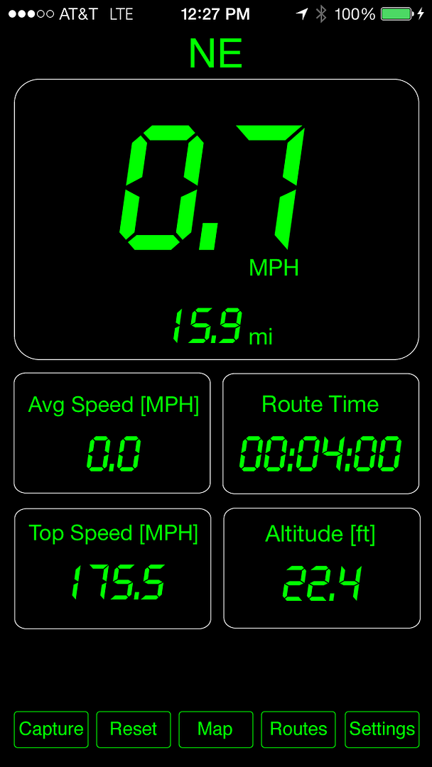

Hey Jimmy, I did some testing today. Pretty much confirmed there is no "top speed" limiter or restriction on my bike. It ran to the 14,200 limiter in probably 3/4 mile with the 16 tooth front sprocket.
This is obviously all she has with 16/45 gearing and a 14,200 limiter. Based off of my math and what it ran today with 16/45 gears, I think it will go 186.5 mph with stock 17/45 gearing... So how people are getting 190 mph with stock gearing I have no clue... Mathematically its not even possible unless they have a taller tire. I'm running the 190/55/17 that has about 60% life left.(has 3k miles on it). Quite a few people here at the forum claim to have gone 191-192 on gps with stock gearing, not sure how seeing what my bike ran with only -1 on the front but... I can't see a -1 sprocket killing 15-16mph off the top speed.
As far as speedo error, using my Garmin gps (in the pics I posted on page 2), my speedo was reading 70 mph and GPS was 67.5 mph, so 2.5 mph off at 70. When I went to make my top speed run, my Garmin GPS lost signal in that area for some reason, so I had to use my phone's GPS and the Speed Pro app.. I have found this to be pretty accurate but it does have a delayed reading, thats why I kept it on the rev limiter so long so I could make sure the phone gps captured the speed. You'll see this in the video. I can not attest to the total accuracy of the phone gps/speed pro app, but I assume its pretty accurate if you allow it to "catch up". My Garmin GPS definitely tracks faster.
I'm working on the video, I'll post it up tonight when its done.

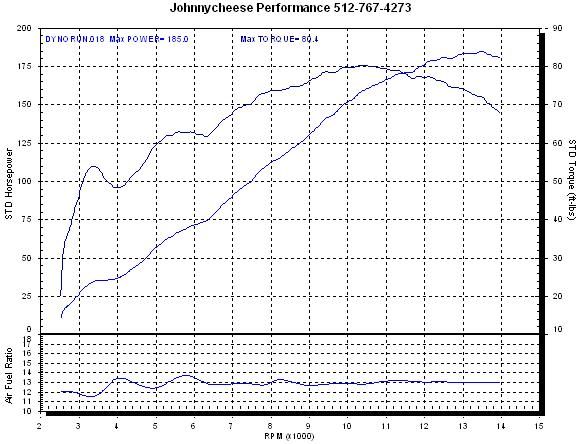

This is my dyno chart, notice how straight the air fuel curve is from 7k on? This bike made the most power at 13.0 afr.. We spent many hours on the dyno playing with different air fuel ratios to see what it wanted... 13.0 was the money. The actual horse power curves always looked the same, only there was MORE power once we dialed it in.
The lumpy air fuel curve down below 6k is due to the throttle position restrictions the ECU has built into... Its hard to tune a moving target.
I started out with Brocks map and made 179, after we tuned it, we ended up here:
And yes, I was a little disappointed. I always heard about all these bikes making 190-195 with Brock pipes and tuning but..... Mine seemed to come up a little short.. However I am running 5w40 BMW oil and pump gas... Not the super thin 0w oil Brock's bikes run.. That is 3-4hp right there. It is what it is..
My point is, get your gearing setup correctly to allow you to run say 195 mph, then make power improvements that will help the bike pull to redline with that gearing.
Personally, Id be leary about reflashing one of these things... If you blow a motor, there will be no warranty coverage... And youre not gonna find one of these engines on ebay for $1k like a busa or GSXR...

Using the Dyno sheet posted earlier in this thread I drew a straight line across from redline to see what rpm the engine could drop down to in order to make as much power as what it was making in the lower gear.
For instance, at 14,200 rpm the blue line is pretty much right on the dot at 180 WHP.
At about 12,200 rpm the engine is also making approximately 180 WHP.
Everything in between has a higher horsepower value.
If you watch the video you posted again, she shifts very close to 14,000 rpm if not at 14,000 rpm for second to third gear change and her RPM’s drop to below 12,000 rpm to about 11,800 rpm which is outside of the window I mentioned above of 12,200 RPM and 14,200 RPM (any RPM outside this ’window’ makes less power as measured by the dyno)
This means she was making more power at the very top of second than then RPM she ended up at in third.
Had she shifted any sooner her rpm’s would drop even further down in RPM’s and be making even less power as you can see on the dyno chart.
On her third to fourth change she once again nearly redlined the bike at 14,000 rpm and wound up almost right at 12,200 rpm which would be the very start of the powerband ‘window.’
Obviously, for the higher gear changes (into 5th and 6th) you would want to shift a littler earlier as the RPM drop for the next gear becomes smaller which you will notice she does.
I realize I said “always better to shift higher” earlier but I was speaking about ¼ mile like I thought we were talking about - where you are going to finish in fourth gear and I stand by that statement as the 2nd – 3rd and 3rd to 4th shift should be done near redline so that after the gear change you are still making near the same power as when you shifted.
Shifting sooner than this will cause you to be in the next gear at a lower rpm than if you held it, resulting in making less power at the start of that gear than had you held it a little longer, not to mention a higher gear does not have as much of a mechanical advantage due to gearing.
