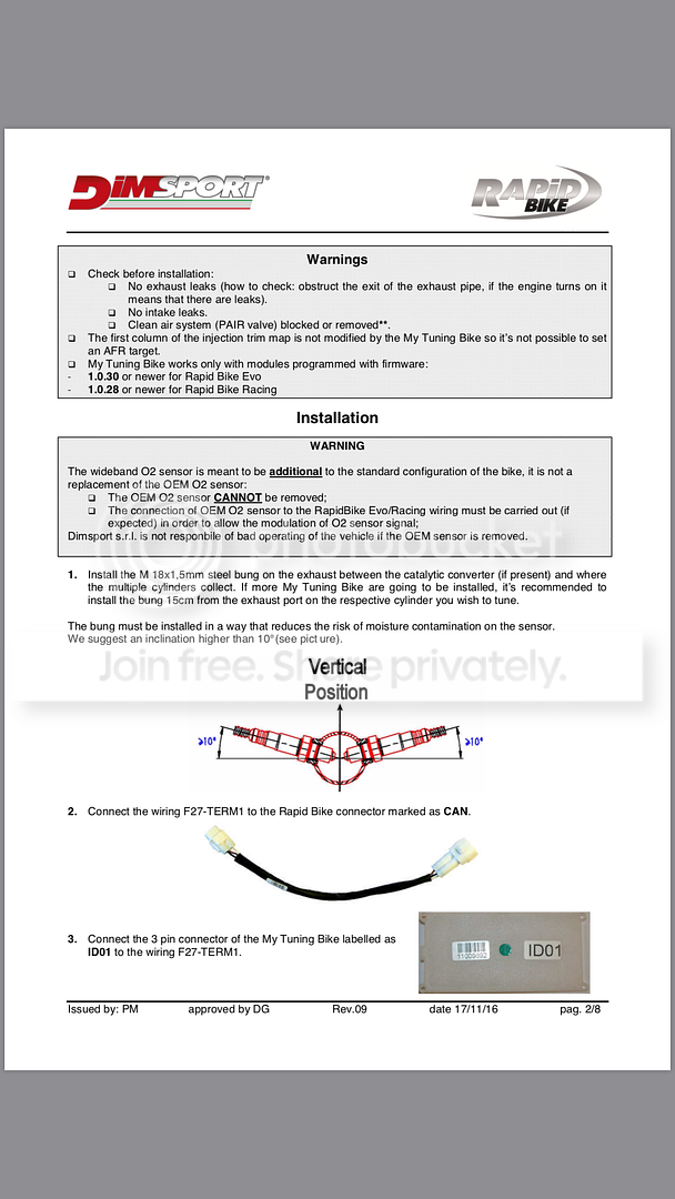

The instructions from Rapidbike says to keep stock O2 sensors plugged and to connect Rapidbike harness to them. Maybe this doesn't account for aftermarket full exhaust?
2014 S1KRR. I have full Akra exhaust, installed Rapidbike Evo with MyTune module and wideband sensor installed. So I guess its reading both stock sensors AND wideband sensor? I am unable to get my AFR to read “OK”, also unable to overwrite my Autotune map onto base-map. I have a feeling its related to stock sensors. U think in my situation i might be ok to disconnect stock sensors as u previously mentioned (from Yaman)?
https://i1064.photobucket.com/albums/u378/karimak2/5B63DC30-F1AE-4A15-A05D-8A01EF2975BC_zpsbcq7lxre.png~original

I have RB Evo with MyTuningBike on my XR, still have the OEN sensors connected as well as the WB sensor. I have loaded' the autotune trim map to the base map, you need to right click on the grid where the trims are and then select the option to apply to the base map. It will clear the AutoTune trim table as well.
I did at one stage disconnect the OEM sensors(reset the adaptations with GS911), ran the bike for several hundred miles, but went back to having the OEM sensors connected as my bike felt better that way. Have a similar setup on my R with the same results.

I have the stock sensors hooked up still. I believe you have to check an option in the RB software if you unhook them. Not sure what the difference is.
