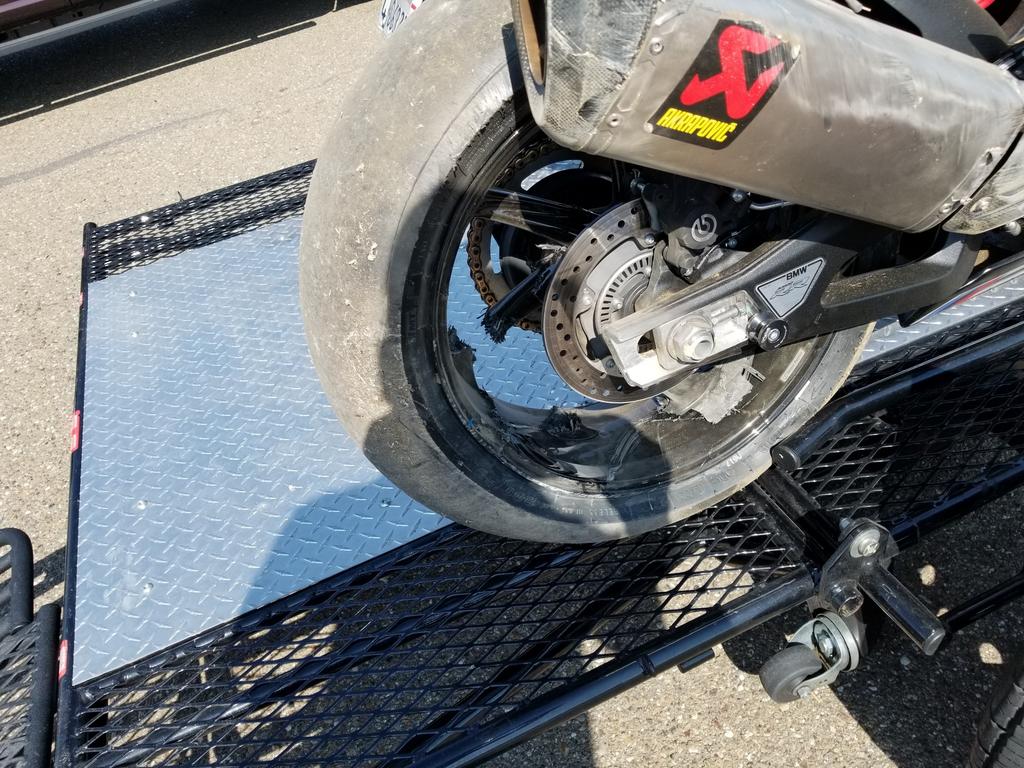

Cracking on the gel coat is a minor gripe to me. If you are going to track the bike, you want forged wheels. The carbon fiber can't handle a crash and there is no way to reliably check them. Back in the days of the BST failures I read that x-rays can't detect damage like they can on mags. I was sure @CYCLE_MONKEY posted something about ultra-sound or other tests but could not find it. :frown2:
If your rear wheel looked like this after a crash, would you trust the front knowing it made first contact? Just asking for a friend.

#78 · (Edited by Moderator)
/quote]
This is a horrible crash but even with a forged wheel I do not think the wheel could have survived.
Carbon fiber is a very strong material but it cannot bent, it only cracks and breaks. In my opinion the CF wheels only disadvantage, if it is made as it supposed to be made, is that it cannot be repaired. Now for the problem in the BMW current wheels I believe BMW will find a solution. This is not an excuse but this is 1st time available to production bikes and there might be some adjusting in the production. My thoughts are that CF is the material of the future in bikes and cars. This is the material that future vehicles will be made...
