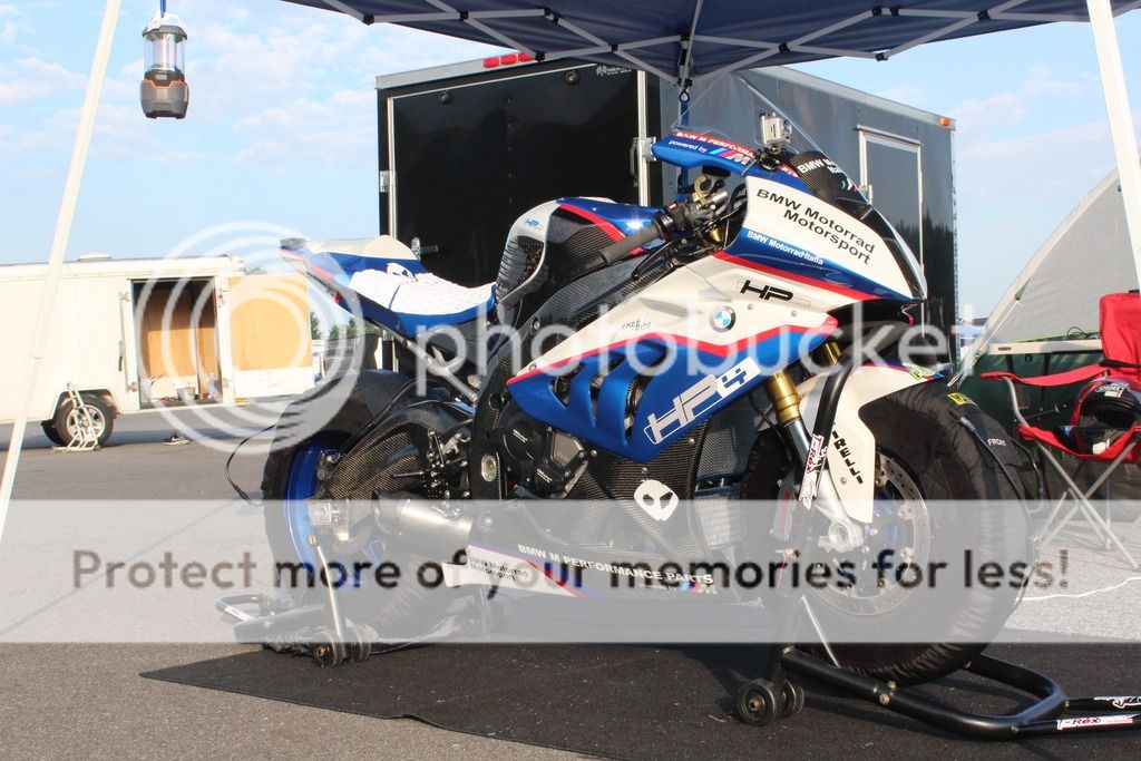

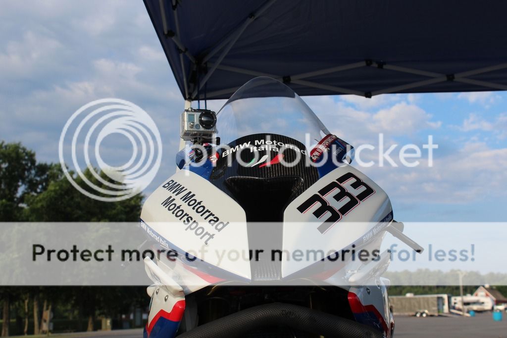

Nearly everything has been installed and a review of some of the new parts is on page 6 I believe. But bottom line, everything works great, looks great, and I am 100% satisfied with the build so far! Pictures from my most recent installs are below!
Bodywork:
-Full Carbon Fiber kit with race tail and custom paint from Moto XP Ricambi
-Stomp Grip tank pads

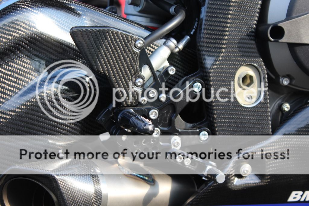

Rearsets:
-Attack Performance Rear Sets
Performance:
-Rapid Bike Racing Unit with auto tune
-Alpha Racing Air Filter
Controls:
-Alpha Racing clip-ons
-Alpha Racing ignition delete kit
-Alpha Racing switches
-Renthal grips with Alpha Racing quick turn throttle (15 degree reduction)
-Alpha racing light and kickstand plugs
-Alpha Racing Clutchless Downshift Blip System
-Alpha Racing WSBK Brake Lever Guard
-Alpha Racing Remote Brake Lever Adjuster
Chassis:
-Alpha Racing Lightweight Alum. Sub frame
-Alpha Racing Carbon Fairing Stay
-BITUBO SSW Steering Damper
-Alpha Racing "Quick Action" Fuel Cap
-2D Front Suspension Sensor
Battery:
-Alpha Racing Lithium Polymer Racing Battery
Chain/Sprockets:
-Regina Racing Chain 520 WSBK
-Alpha Racing Front/Rear Sprocket (Stock Gearing)
-Alpha Racing Chain Adjuster Kit
Exhaust:
-Full Arrow Ti with shorty
Protection:
-GB Racing case savers
-Cox Racing radiator guards
-Alpha Racing Carbon Swingarm Protection Kit
-Alpha Racing Carbon Frame Covers Kit
Brakes:
-19RCS Brembo Master Cylinder
-Spiegler Brake lines (front and rear) **UNINSTALLED AT THIS TIME**
-Brembo brake and clutch levers
-Alpha Racing Front Brake Pad Set Duo Sinter BMW HP4
Electronics:
-Alpha Racing Plug & Play Color Dashboard

ImageUploadedByMO Free1433441695.869926.jpg ImageUploadedByMO Free1433441711.459613.jpg ImageUploadedByMO Free1433441725.666677.jpg ImageUploadedByMO Free1433441750.243144.jpg ImageUploadedByMO Free1433441760.693938.jpg ImageUploadedByMO Free1433441772.850350.jpg
Attack Rearsets, Arrow exhaust, stompgrip tank pads, Cox Racing radiator guards, and GB Racing case savers all installed. Body work is ready for install but won't be going on until brake lines get installed.

fixed the throttle cable, just came loose from the bracket... clip ons, quick throttle, switches, ignition delete, and AIM Solo DL all installed. Once the Rapid Bike gets installed, the body work will go on and it will be ready for the track! Almost done, just another day of work and it will be ready to go! Full photo shoot after everything is done next week...
