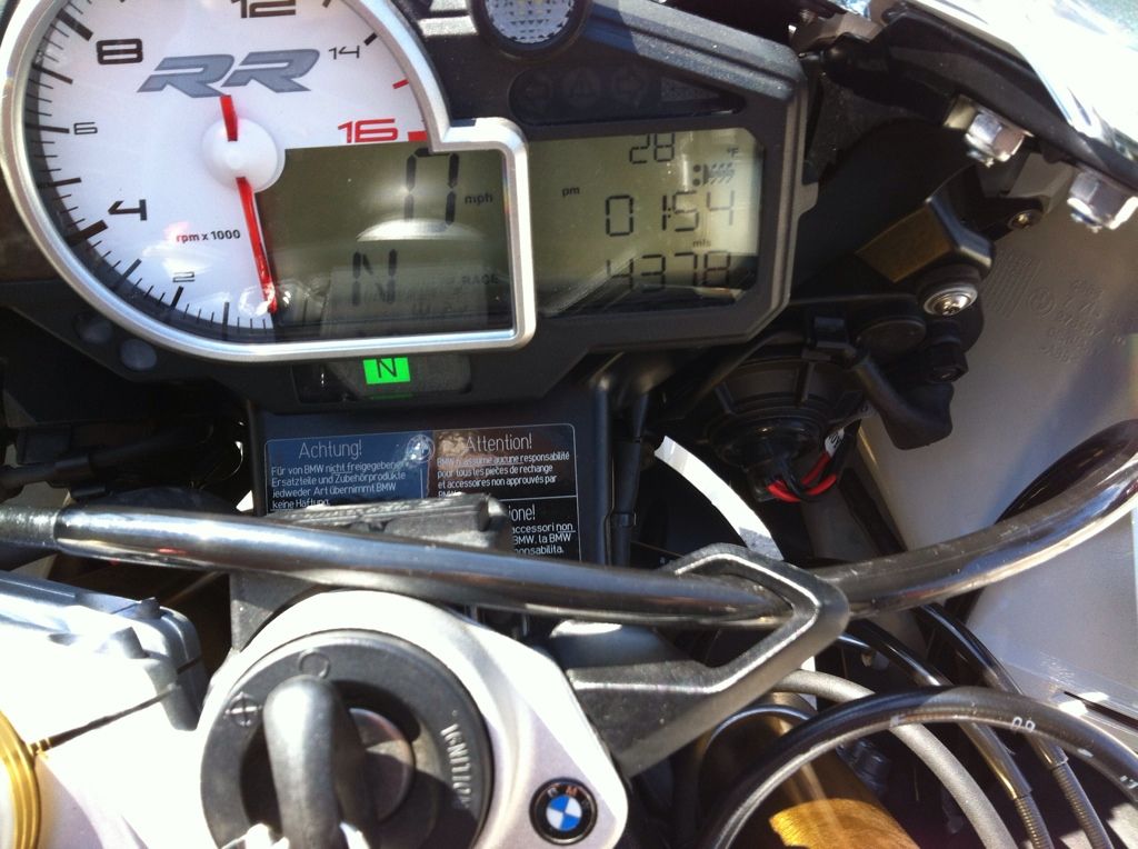

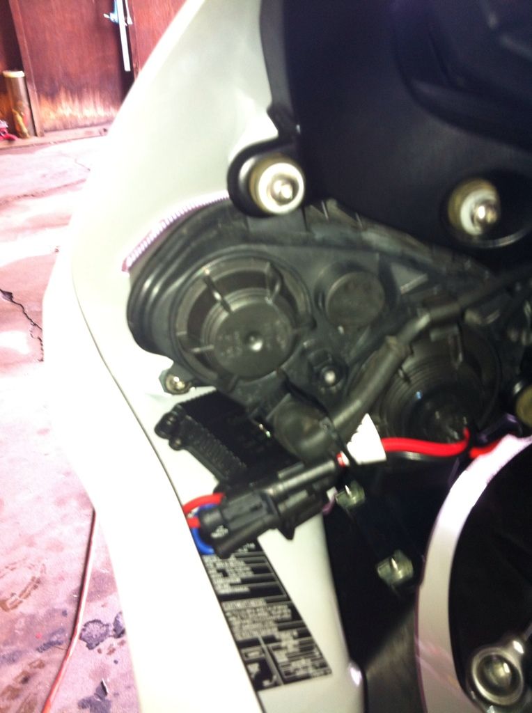

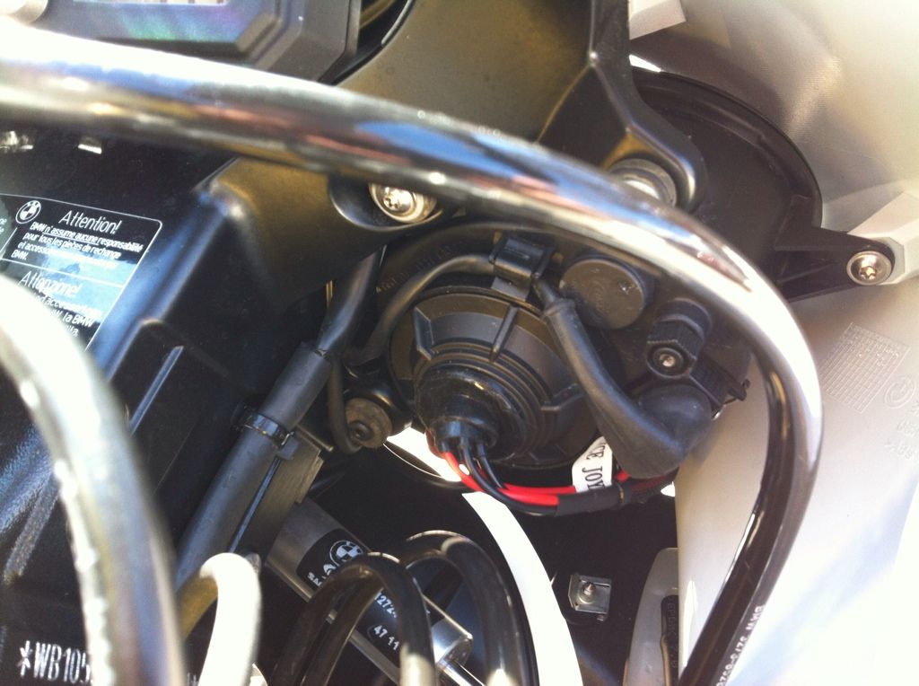

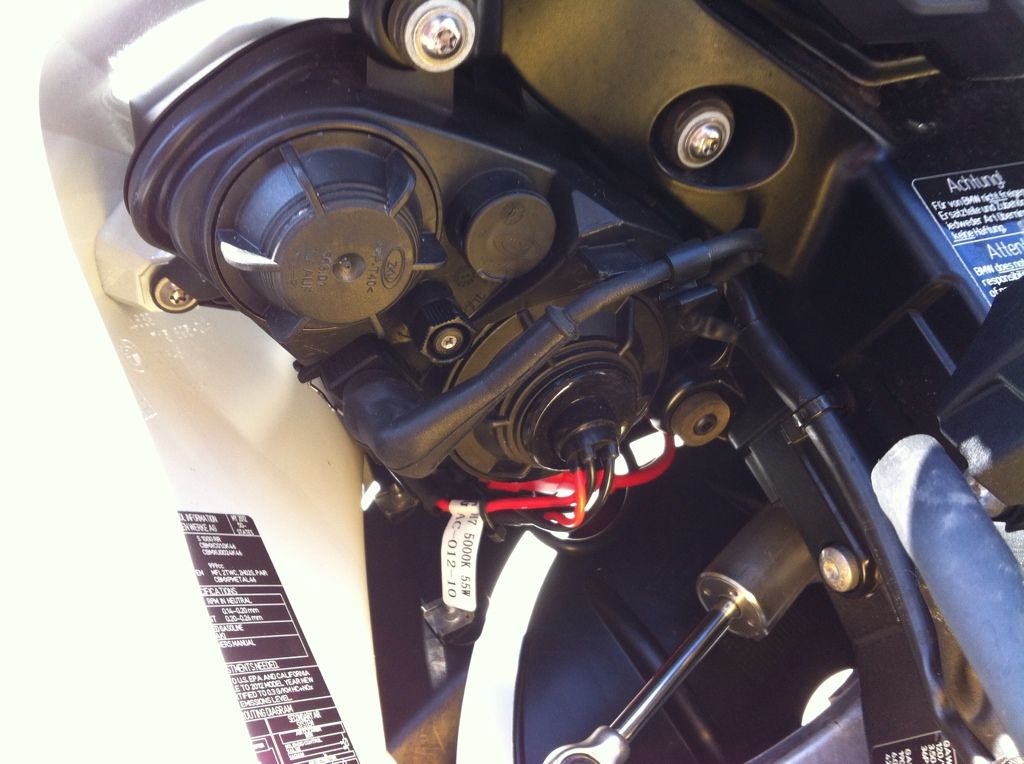

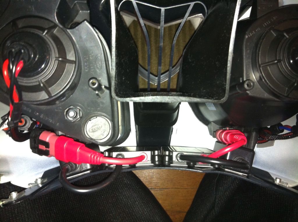

Just wanted to say thanks to the op and everyone on the thread. I found it to be a big help to me while installing my Gotham 55W 5000k HID. I Did try to install them without removing the front fairing but I just couldn't hide wires good enough so that I was happy with it or that it was out of the way of the steering. So I took the fairing off just so I could hide everything better but I found that to be tough as you don't really know whats going to interfere once you get it back on. After several tries and removing the front fairings twice I found a great spot for everything. Everything is completely hidden, looks great, and is out of the way of the steering.
My first try at it
How I ended up doing it after several failed attempts at hiding the wires and stuff
2012 racing red/alpine white

Nitronut, that looks awesome. Nice and clean. Thanks for posting.

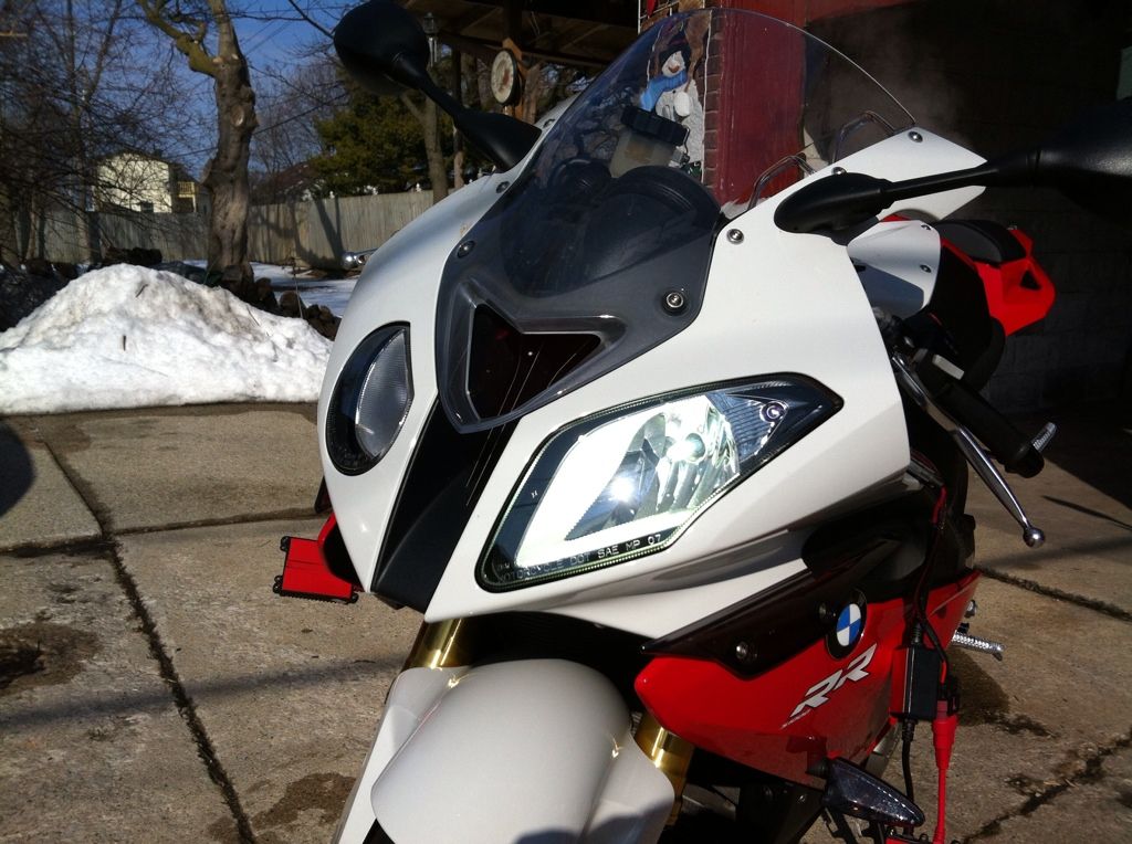

Yea I agree thanks for posting, looks super clean. Take one of the bike with the HIDs on if you get some time

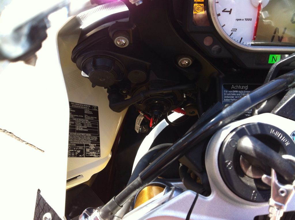

More pics as requested. Everything is back on the bike and well hidden

I'm not very wire friendly...where exactly do those spade plugs go into? A picture would be great! Thanks in advance

I guess I'm not really sure what your asking. If you look on page one of this thread you can see a pic of the HID kit and get a idea of where the wires go to. After its installed 4 wires come out of the back of the headlight assembly. 2 of those wires go to the bulb and the other 2 plug into the factory plug that use to be plugged into the factory bulb
