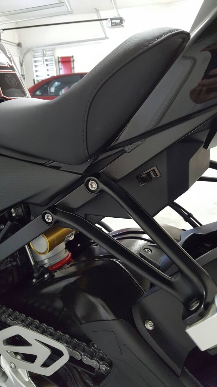

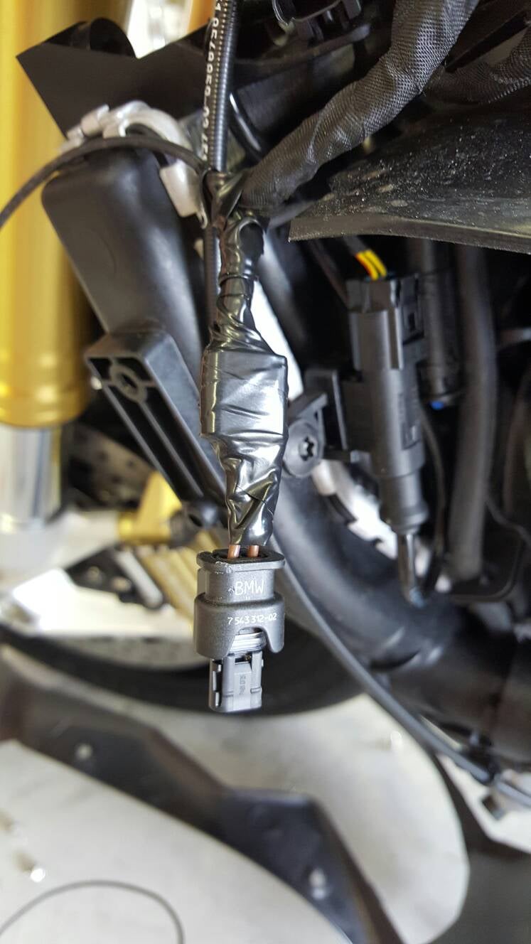

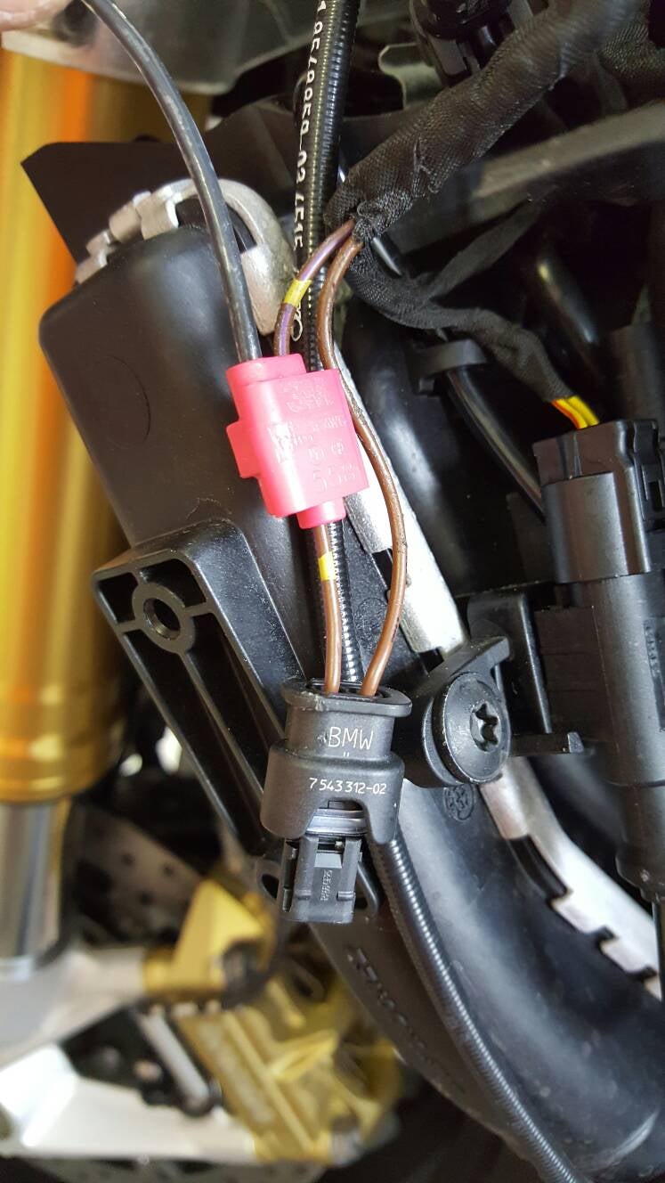

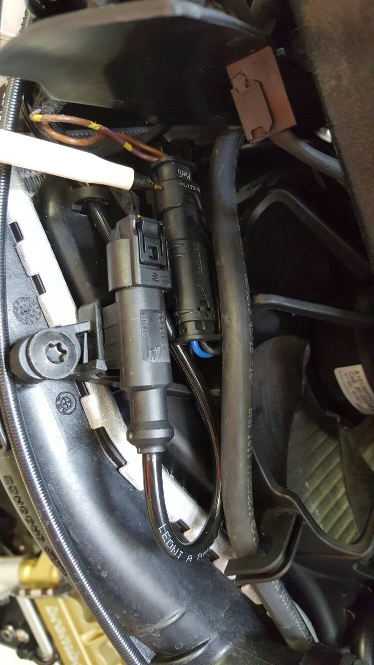

Take control of your fan with this easy mod. The connector is located on the left side.
I spliced into the brown with purple strip wire which is the + 12v the solid brown is the ground. I then ran the wire neatly to avoid any pinch points back to the battery box.
Installed a 5amp in line fuse to a simple rocker switch. The fan will run when ever you want and also come on when the bike reaches 215 degrees.

It is not only unnecessary, it's quite stupid to be honest.
If you're XXXXXXXX enough to think this is a good idea still, keep in mind there's no need for an additional fuse, the OEM fan circuit is of course fused and adding a fuse adds one more failure point.
I'm not sure when, or why, the public got to believing engines should run cold. They shouldn't. You oil is designed to run at 240-280 degrees, and your coolant is designed to run 200-220. This is important, and it is supposed to be that way. When your bike hits 216 at a red light, and the fan kicks on, this is OK, normal, and not in any way bad! Hell the newer BMW cars run their coolant up to 250 degrees at times, on purpose by design.
Your bike will not overheat. Period. Quite frankly, there isn't a situation you could put your bike in that it will overheat. It'll get 'hot,' maybe even hitting 230, but it won't overheat and won't do any damage. You could sit at idle in death valley on the hottest day on history and it won't overheat.
Unless you have a component failure, it is impossible to overheat your bike in any foreseeable operating conditions. This includes death valley. Not only will the bike simply not get that hot, but even if it managed to overheat, let's say you had a radiator airflow blockage, the ECU will do whatever is needed to prevent damage. It'll pull ridiculous amounts of timing, run crazy rich, limit throttle, and even shut down completely prior to damage.
Leave your cooling system alone. Want to do good for your engine? Install a block heater and use it.
