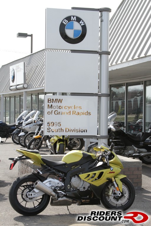

We owe a special thanks to BMW Motorcycles of Grand Rapids for helping us acquire the bike so quickly!

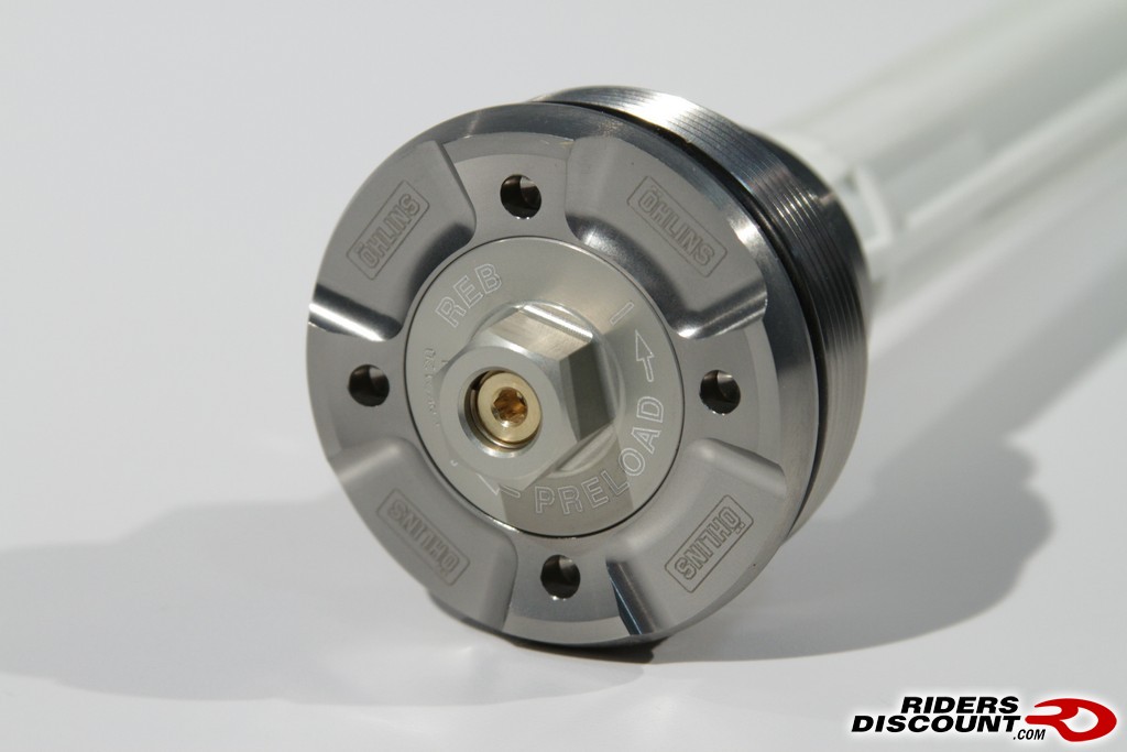

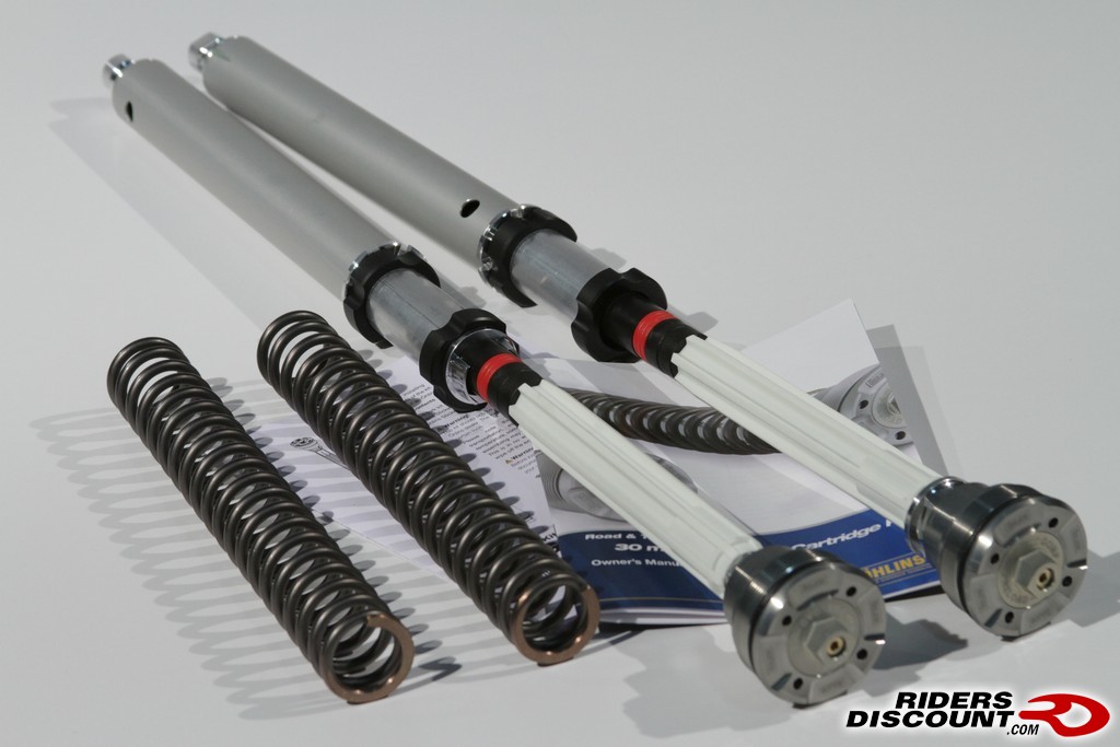

30mm fork internals waiting to be installed.
The fork caps are a work of art.

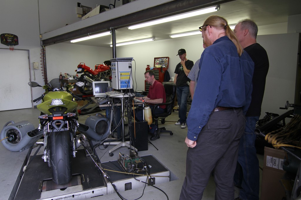

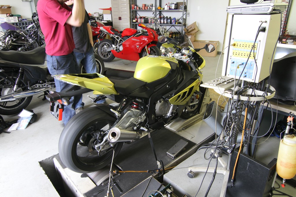

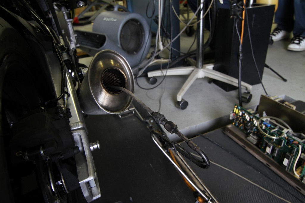

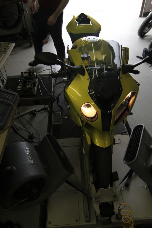

We took the BMW S1000RR to the dyno after having the rev restriction taken off with the 600 mile service. The end result was over 182hp on a Superflow Dynomoter with 89 octane pump gas. We have the guys at FastBikesUSA to thank for getting us in since their dyno schedule is pretty busy this time of year!
The guys at Fast Bikes use a four-gas sensor to monitor air/fuel ratios.
Wherever this bike goes, it gathers a crowd. This was the most powerful stock liter bike they'd ever seen.

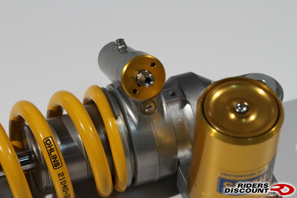

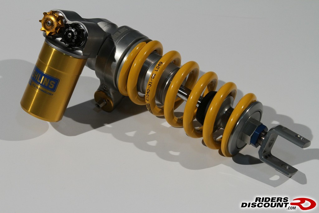

We've acquired the shock that's going into the S1000RR.

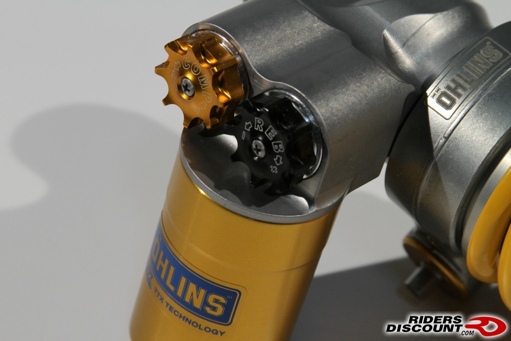

As usual, Ohlins continues to up the ante for better functionality and reduced weight. The preload adjust is no longer a large, separate piece, but instead is one with the shock's body.
Machined compression and rebound adjustors are not only gorgeous, but also make it easier for suspension tuners to swap out different types of valving in a hurry.
