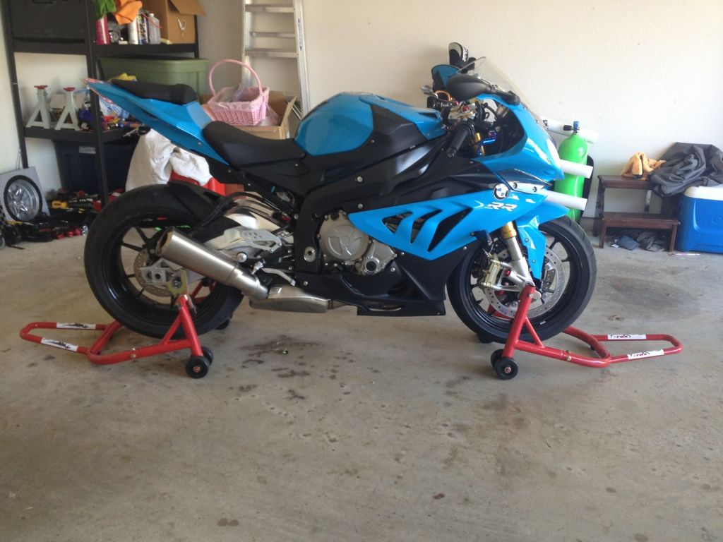

I was wondering if anyone has used or owns one of these stands for the S1000RR. What attaches to the bike? Does it or can it potentially scratch or damage any thing on the bike. Is it good for long term winter storage? Durability, I would hate to bump it wrong and have it fall off.

That sure is a nice Blue! I like the idea of this stand for removing the front and rear tire and working on the forks and suspension. Also as a bonus storing the bike during the long ass winters here (5 months or so), can just wheel it into a small space and make room for the snowblower.

I have a motomfg stand it works great, now. I had my bike on it all winter, it won't fall off, it uses a pin to secure it. With the bikes weight on it you'd really have to jerk on the pin to remove it, my kids have been bench racing on it like crazy! Lol I had major problems with the plate that goes into your frame. The lower frame pin had to be offset in order for it to lift both ends equally. Its adjustable but when i adjusted it til the bike was level it would bind in the frame and the stand would be impossible to remove.I threw the one away that came with it.went to my shop and made my own. Works perfect now.
